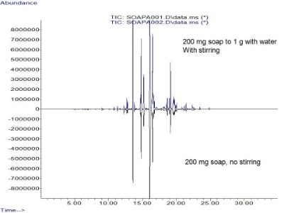

Yes, FID. Hope this print works.[img]"C:\Users\Psycho\Documents\Track%20GC%202017\Track%20GC.jpg"[/img]
Yes, FID. the beginning upward stroke remains constant size no matter how much sample I inject. At the 2/3's point of up peak the path begins to falter to the right then rounds off the peak top point. The downwards fall seems 'lazy' in that it is not more of a straighter angle.
At bottom of image there is a column "Area counts". I normally get a result of how pure test sample is. Now nothing.

Looks to me like that link is pointing to someplace on your C: drive on your computer. You'll need to upload that to site that will allow image sharing. Here's one of mine from my "photobucket" account:
http://i1285.photobucket.com/albums/a59 ... ab8b6a.jpg
